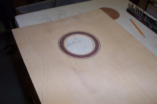

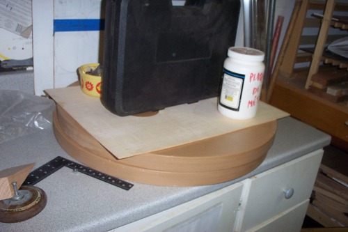

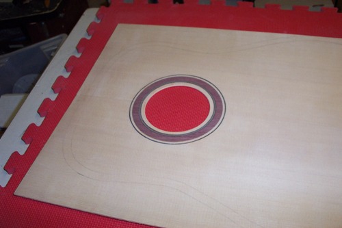

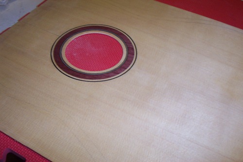

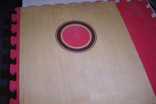

Well, the top plates were sanded down to 0.113" , the soundhole was cut out and sanded around the edges, like Anthony advised, i put a couple of shellac coats and like Shane advised, i put my top plates in my sanding dish and had put weight on it! Man, when i reread myself, i sound more and more like an obediant student! don't ask me for sit ups and push ups tho!
Here are a couple of piccys!

soundhole edges sanded
Shellacked
resting in the 25' radius sanding dish

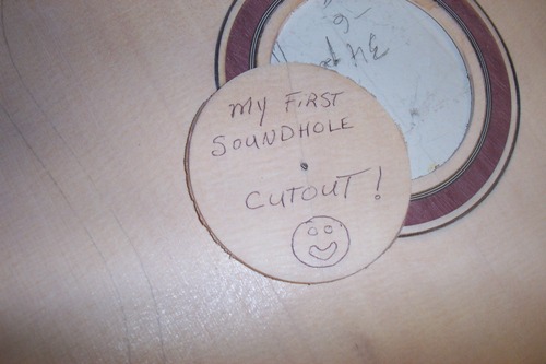

Looks like things are coming along nicely. I don`t even see a hint of that dent! Hey, save those cutouts. you might be able to make `em into wheels for the kids.

Looks good. A suggestion (maybe unnecessary) - if you are going to use a commercial shellac, make sure it is dewaxed.

I save the sound hole cutouts also. (Learned that from Dudenbostel on the Handmade Music segment) I write the serial #, model, soundhole size, woods used, etc. on it, and put them in a safe place. Got three so far!
Don't know that there is any benefit to it, cause all that stuff goes into an Access database anyway. But I thought it would be kinda cool to have a bunch of them...

Thanks for the encouragement, cool idea to keep 'em cut outs with the specs of that particular build written on them, a string to suspend them or a board to display them sounds right also!
Jim, good idea, i don't remember if it was dewaxed or not, i'll check, Thanks!

Great job Serge. I have a suggestion if you know the size guitar and shape you plan to make. Go ahead and trim it to slightly oversize shape. Makes it a little easier to store and handle.

Looking good Serge! Looks like the dent is gone and the joint closed up as well. Great job buddy, keep it up.
